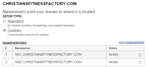

I already have the name server *domain names* defined for the domain at godaddy (I haven't touched it as the domain names of the name servers never changed). Godaddy does not allow you to define IP addresses with the domain names, just domain names as name servers.
"Edit Nameservers" only allows me to change the domain name of the name server.
