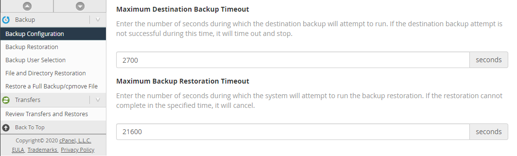

Here's where those settings that JonathanKW mentioned are located:

The Maximum destination backup timeout was at the default setting, I think it was 2700 which is 45 minutes. I have now changed it to 6 hours.
